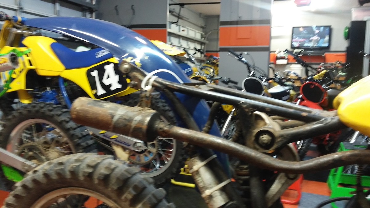

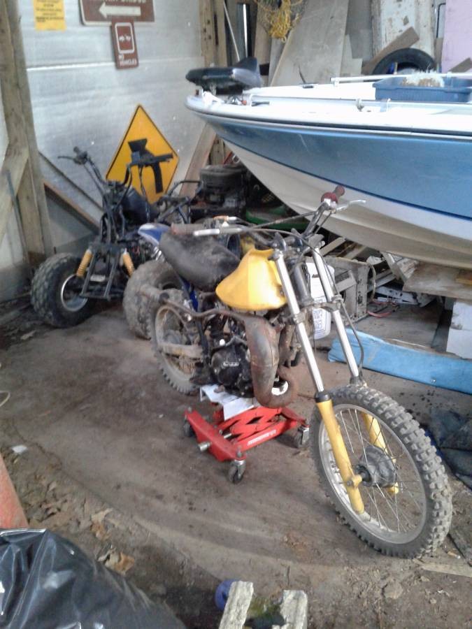

Hi Guys
After finishing all 80cc Mini bikes from 1980, I picked up an RM80D 1983 first water cooled from craigslist a couple of months ago and I been working on that mini beauty since then.
To be honest, when I bought I knew it was in bad shape, but I never thought it was so rough, even the guy I bought it from New Jersey, for who knows the reason after I got it, never replied me again when i send him a couple of pictures of the progress as he asked me for!
I will be posting some pictures of the before and some of the progress

That's some damn good looking progress you're making.
Is that bondo on the pipe in the first set of pictures? I guess that's one way to take care of dents...
