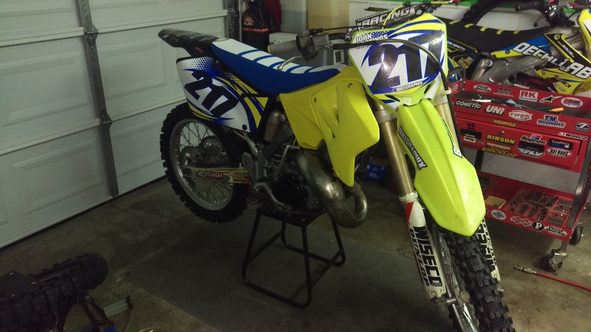

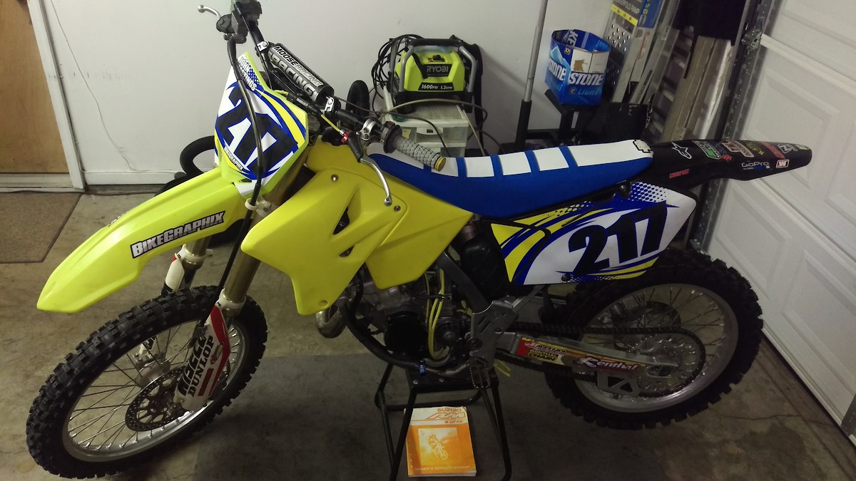

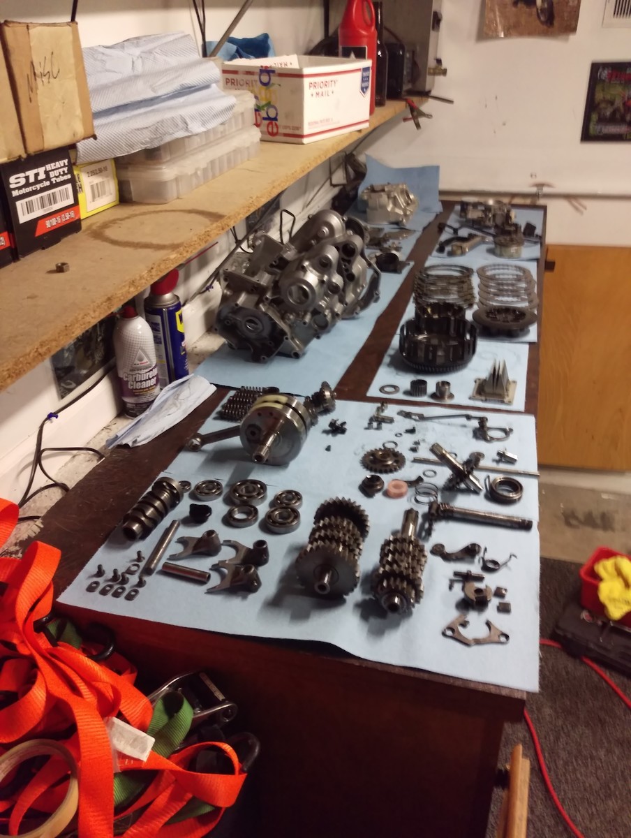

I rebuilt this 2004 rm125 for a friend of mine.

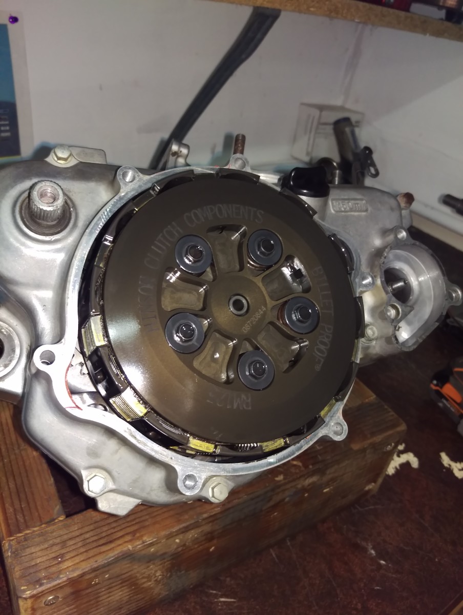

Full Hinson clutch
Wossner piston
V-force 2
FMF pipe
Bud racing silencer stainless carbon tip
Braking oversized front brake rotor kit
Works Connection frame guards and skidplate
Updated flo front fender and number plate
Bolt complete plastic bolt kit
Universal triple clamp
Pro taper bars and grips
Dunlop tires
Primary drive O-ring chain
Sunstar sprocket
Bike graphics kit and custom seat cover
MX bonds yellow carb hose kit
Outlaw shifter
Quick adjust perch and yellow cable
Billet fuel tank breather
After some graphics were installed. Arenacross

Good find onn the Hinson hub and pressure plate
Hondas4Life3 Hondas4Life3
1/22/2018 6:23 PM
Bruce372 wrote:
Good find onn the Hinson ...more
He actually got lucky on the Hinson components. He purchased the bike and the previous owner had just installed the whole kit.

Nice!! Where'd you find flo yellow shrouds & tank. I just rebuilt an "05 and an '07 and was looking for flo. plates and side panels. Couldn't find them.
1/24/2018 4:54 PM
Ozzyrules wrote:
Nice!! Where'd you find ...more
The side panels are OEM suzuki yellow. The front number plate and front fender is New RMZ stuff from Acerbis that I modified a bit to fit.
Ozzyrules Ozzyrules
1/24/2018 5:49 PM
Aaaah, ok. It was hard to determine that in the picture's lighting. Nice job on it!

Hahaha not the first to say something about the screen name. I ride a Honda but it seems like every bike I work on isn't a Honda.. (hmm maybe I'm onto something.) This bike had a leaky left side crank seal that eventually took out the main bearing.
