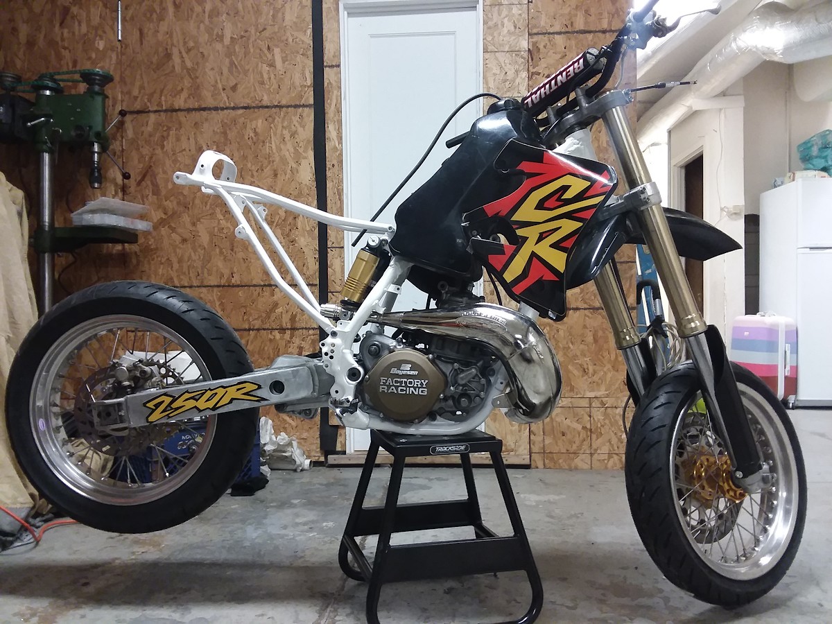

It looks like everyone is building a steel frame cr, so here is my contribution. Street legal 94 cr 250. Front suspension from an 01, revalved and resprung, rear shock from a husky 450 smr. Wheels are from an atk sumo build that the guy lost interest in 20 years ago (they were cheap). Good thing becuase I had to machine the brake side of the hub down! Also, had to make a new front axle to work with the fork, bearing id combo. And all of the polishing. So much polishing.

That bike will be a hoot on the street! What year husky 450 shock is that? I have a 94 as well.

I demand more pics w00t

Yhea, the shock is from an 06 450 smr. It had a small leak, so i ended up rebuilding that as well. They mostly bolt right on. I did have to trim the upper mount hole and trim about 1/4" off the mounting bracket as the sachs shock body is larger. Length is 1/2" shorter and i had to make some spacers as the widths are different on the sachs shock. But these shocks are nice and cheap.
I will edit some pics and upload.
