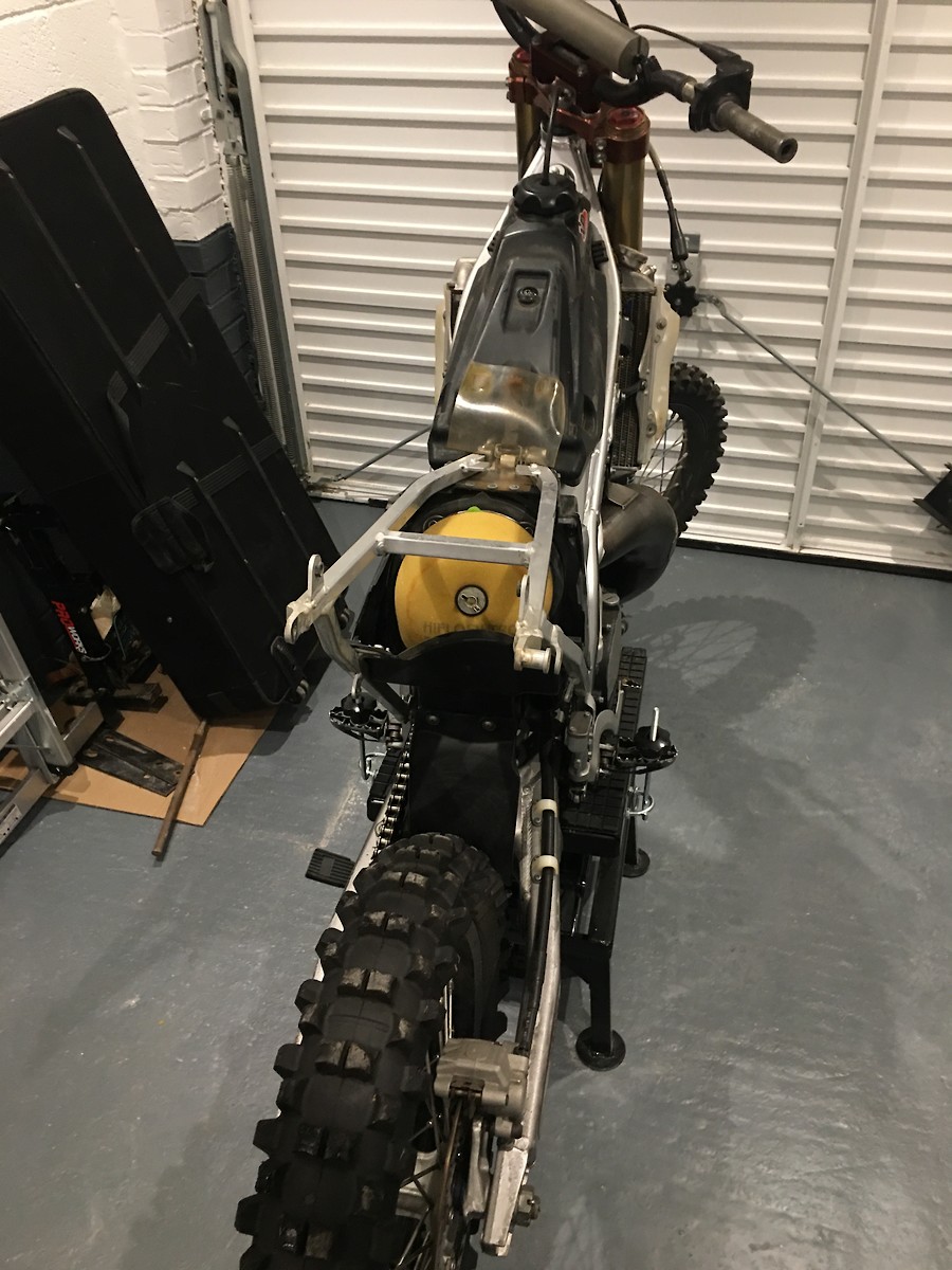

Started off with the idea of just rebuilding my 2005 KX250 after it sitting in the garage for 8 years collecting dust, what thought would be a quick strip down check and rebuild has ended up turning into a full project build with the budget more than doubling what I first thought it would cost 🤦🏼‍♂️😂😂
As I started stripping it down it came clear to see that 8 years sat in the garage has done way more damage to it than I thought!

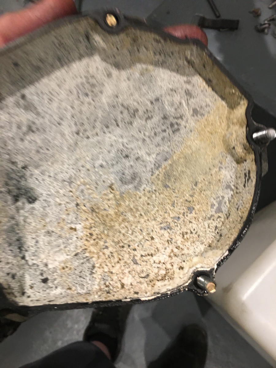

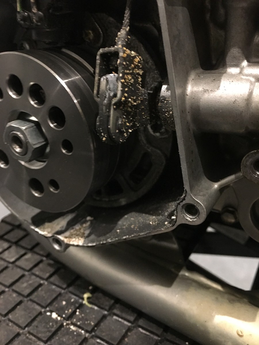

Stripped the engine and found nasty gunked up coolant. Plan is to replace every bearing and seal in the motor, also plan on having a local two stroke specialist port the cylinder and machine the head then jet and map up my JD ignition correctly, also having a complete new clutch basically entire new motor other than casing, transmission is being super finished also.

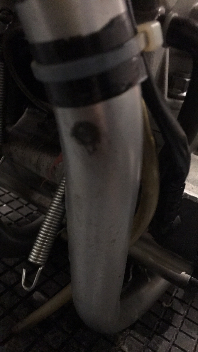

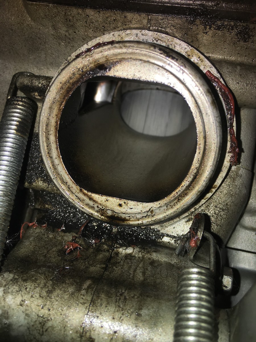

Yeah it’s not good pretty everything on the bike is either seized or gunked up, I wondering if my coolant was so bad cause of a hole in the water pipe elbow out of the water pump cover if it had possibly got air in or maybe it has just corroded by its self over time.
Yeah the late model KX’s are so good can wait to ride it again.
Water pipe elbow with hole

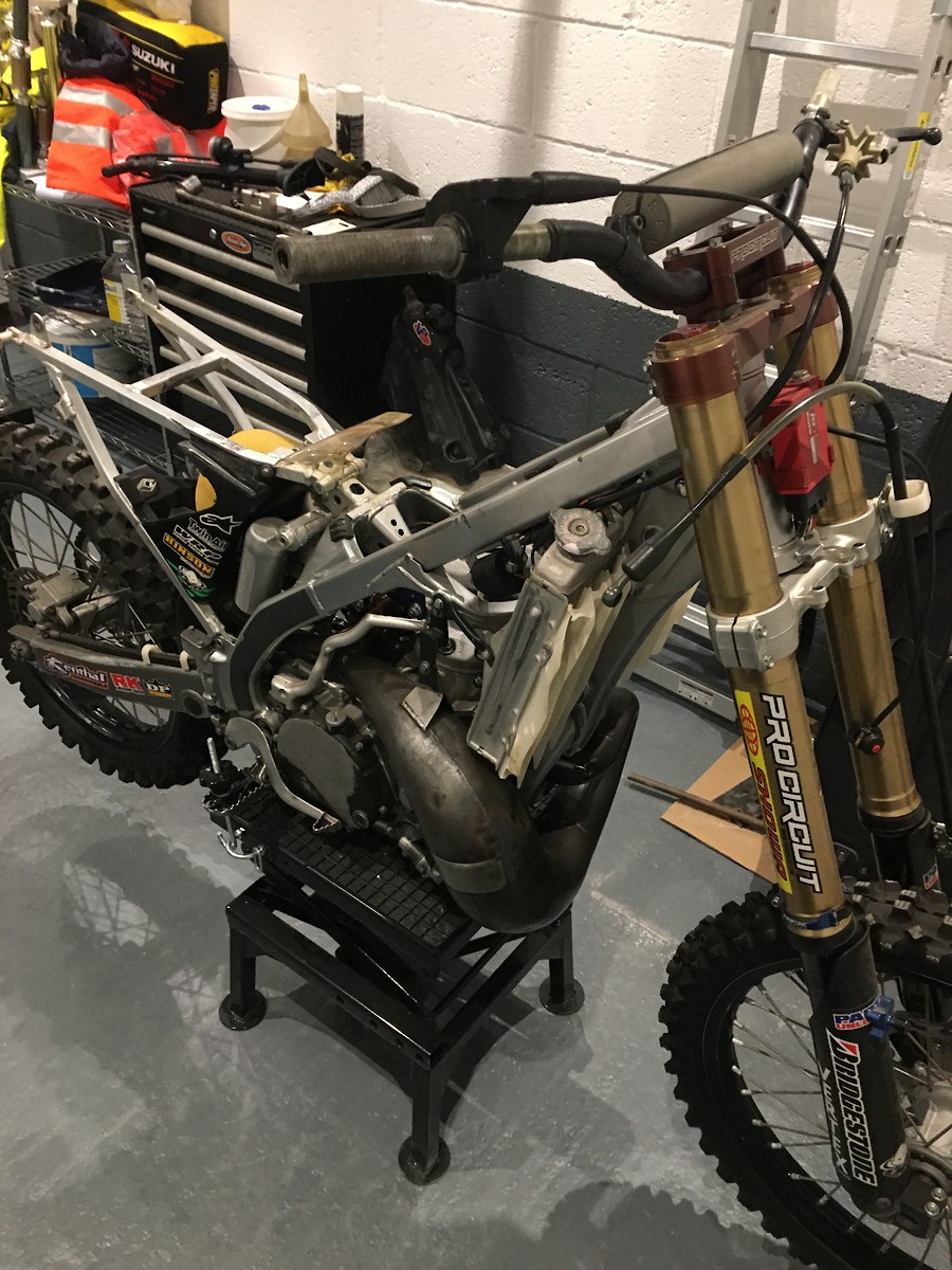

Some more progress, more vapour blasting and cleaning parts, also we had a engineering shop mod my pro circuit clamps to fit the 2stroke as they used to be for a KTM 450 but I am putting my pro circuit A kit forks in the bike so needed to right size clamps to go in to match.

A little more progress, I got the frame and swing arm back from the powder coaters, got new bearing fitting in and got the modded pro circuit clamps in and my pro circuit A KIT showa forks
