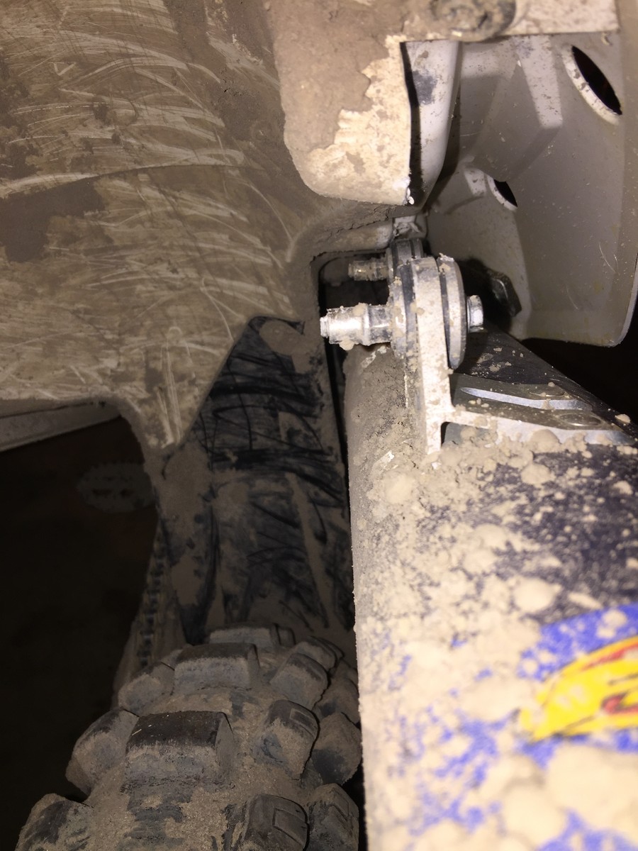

Is this common and what is remedy short of new subframe

I've never seen that. Could hack together a longer bolt with washer and nut on the back to hold it together or a new subframe. New subframe isn't super expensive.

I have not had the inserts come out, but have had other problems with those bolts probably due to bent pipes in my case.

Not common. There has to be more to this story. Loop out? Something to put serious stress on the sub frame.

Bolts are still tight. Inserts came out. No crash no anything. Smh

Have someone weld the inserts back in. Shit happens with all dirt bikes.

What about a repair with s timesert or helicoil and use green loctite retainer?

Weld them back in
You realize that the inserts are steel and the subframe is aluminum right?

Our 16 KTM 125 with only 5hrs had loose inserts. I added some red loctite to get by until we sold it.

Could have the holes filled and then drill and tap out the alum.

Nut and bolt it, but the subframe looks bent
No logic should silently say this issue was caused from a previous crash..
