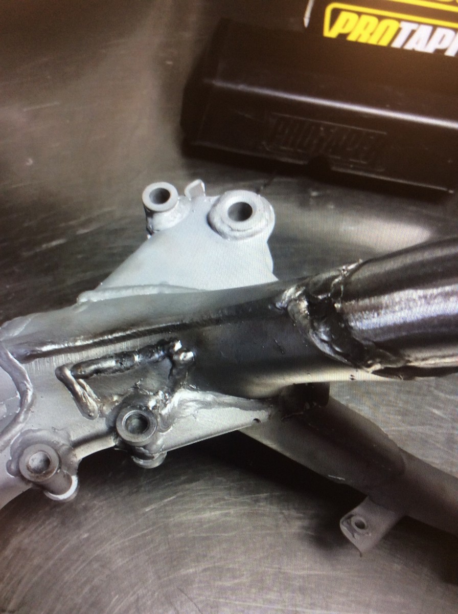

Been a while since I did a frame off build, picked up a 93 CR250 working on building a competive track bike.
Just got the frame back from the weld shop, gussets add a the areas the factory bike we're modified, dropping off at power coaster tonight Photo

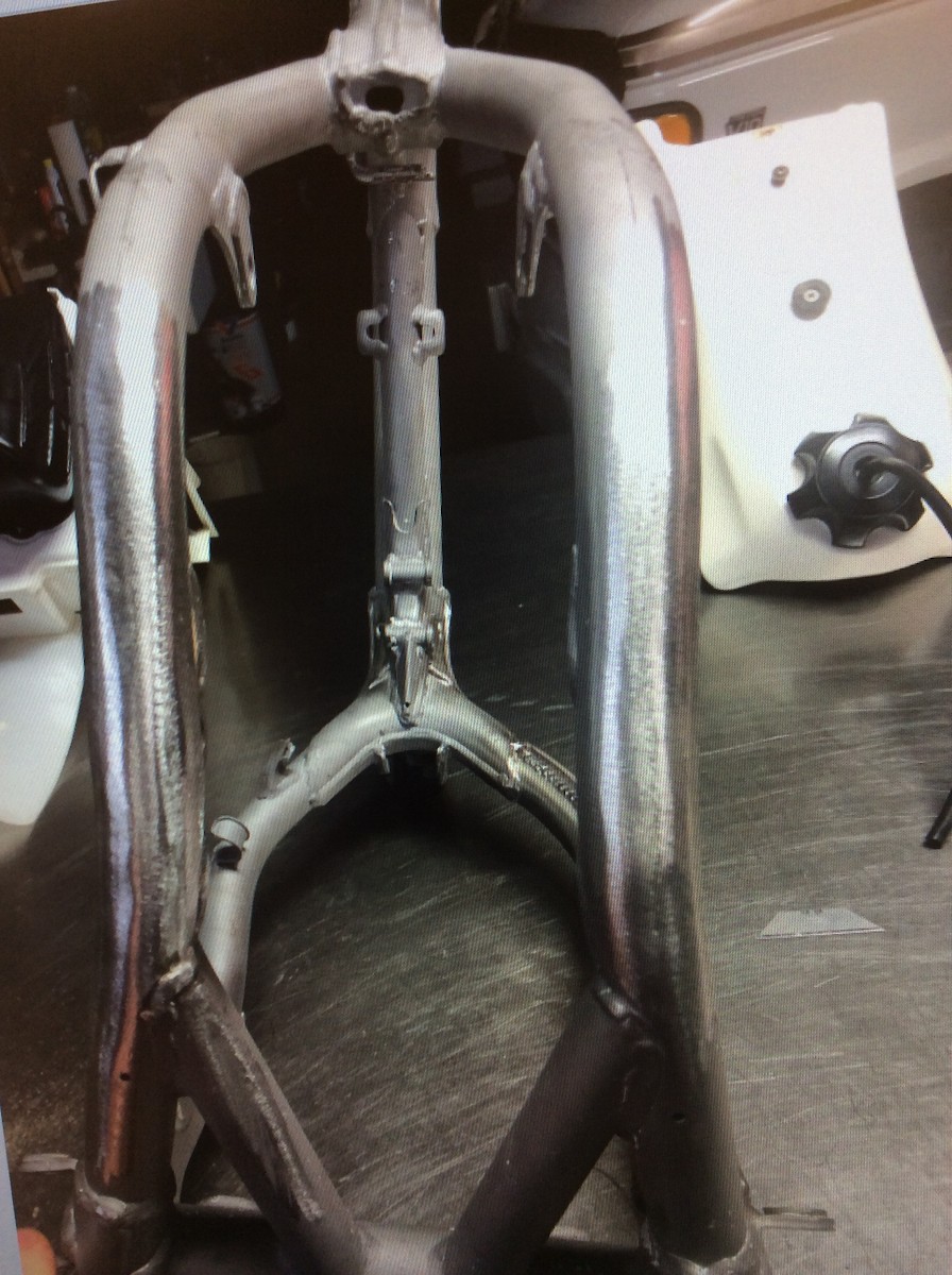

Awesome, I am getting ready to do a 1992 CR250 Build.
Do you have any Documentation on exactly how and where the Teams added those gussets?
Cant wait to see how this build turns out.
wolfy0067 wolfy0067
5/29/2020 3:28 AM
Here ya go , hold on the swing arm for now, want to see how the frame changes work, then do the swingarm mod.

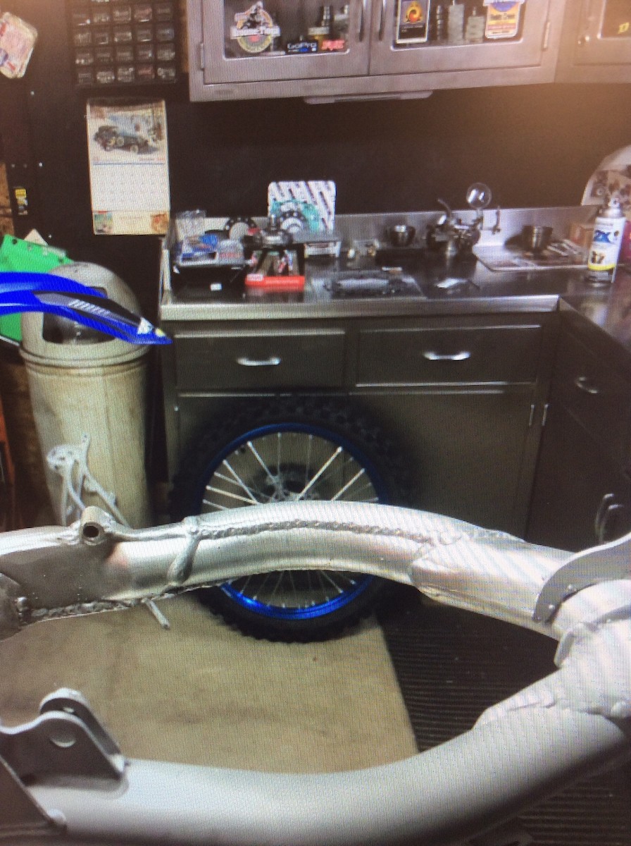

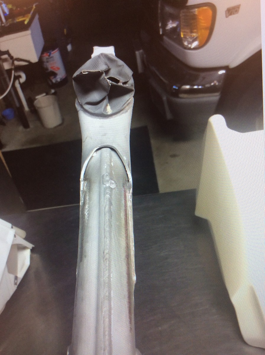

The gussets and welds look great. How did you shape them to fit the frame?
wolfy0067 wolfy0067
6/7/2020 4:34 PM
Got lucky having some touring, shaped it then grind, tack weld and work on forming it into place

This is not going to be a replica build
