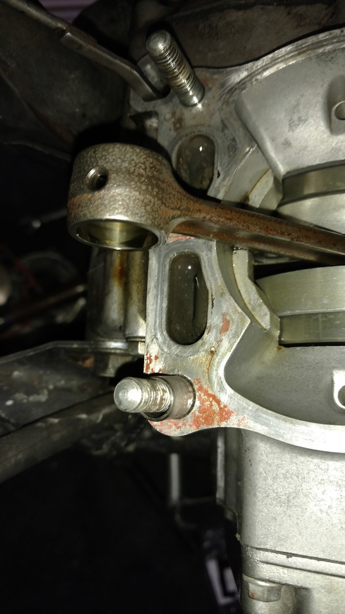

I am changing out top end and managed to drop a circlip down the cooling port.
How do I go about getting it out?? Photo

I'd probably pull the motor and stuff some rags in the crankcase so it doesn't fall in there and try turning it upside down and shake it out or even use an air nozzle to try and blow it out

Tiny magnet on a string?

Buy a telescoping magnet from an auto parts store

Got it! Used magnet strip and worked like a charm after a few triesPhoto
