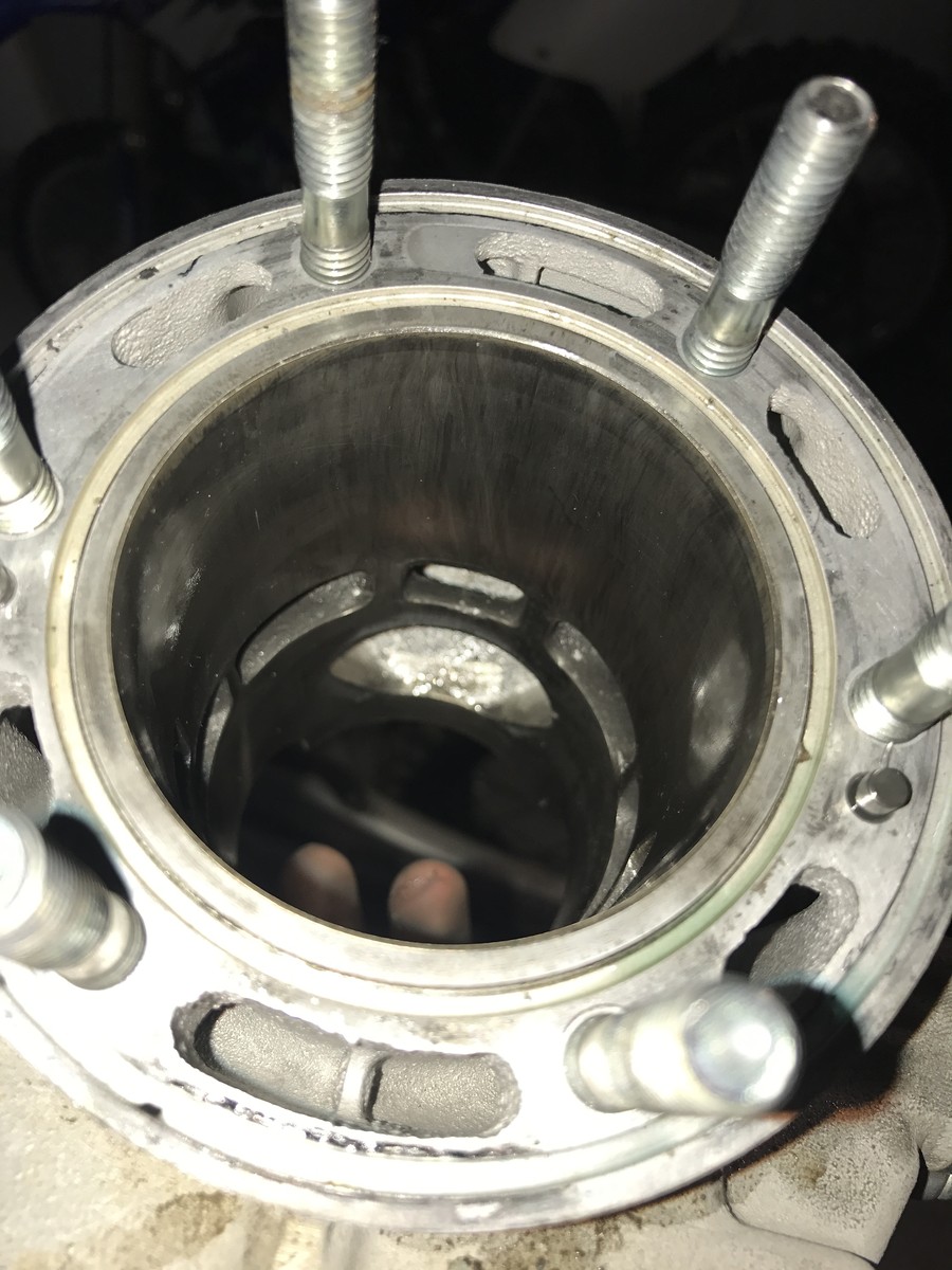

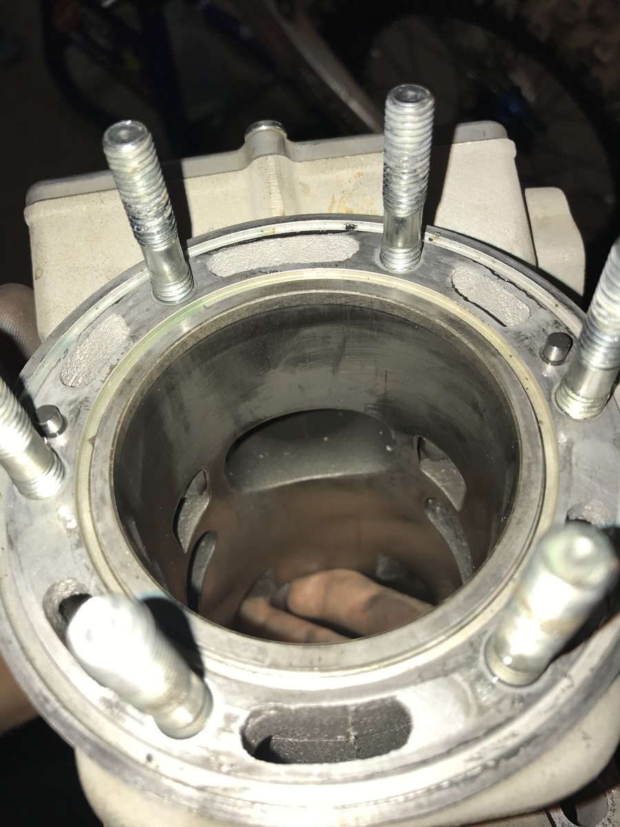

What's best to do with this cylinder? I pulled it off the bike that broke a piston skirt. Some small scratches and nicks in it you can barley feel with your finger nail. Do you guys recommend a re-plate process, hone it or bore/hone if needed. Im guessing this cylinder has the nikasil playing? If I'm correct? First time messing with a cylinder like this. I need to clean up some of the oily residue off the walls and get better pictures maybe but this what I took wuick last night

Ive seen cylinders work perfecly fine with small nicks in the walls. I would still get it replated at millennium. Dont chance a ring getting caught up on a bur or something like that and blowing your bike up again. They have a ton of yz250 cylinders they can swap for you for quick turnaround. I sent a yz250 cylinder in and got a new one back in about a week and a half. I think the term is “core exchange” or something like that on their paperwork

The cylinder needs to be reworked and plated. I would also suggest taking a look at your squish as the head shows some very light signs of detonation on the edges of the squish band.

The cylinder needs to be reworked and plated. I would also suggest taking a look at your squish as the head shows some very light signs...

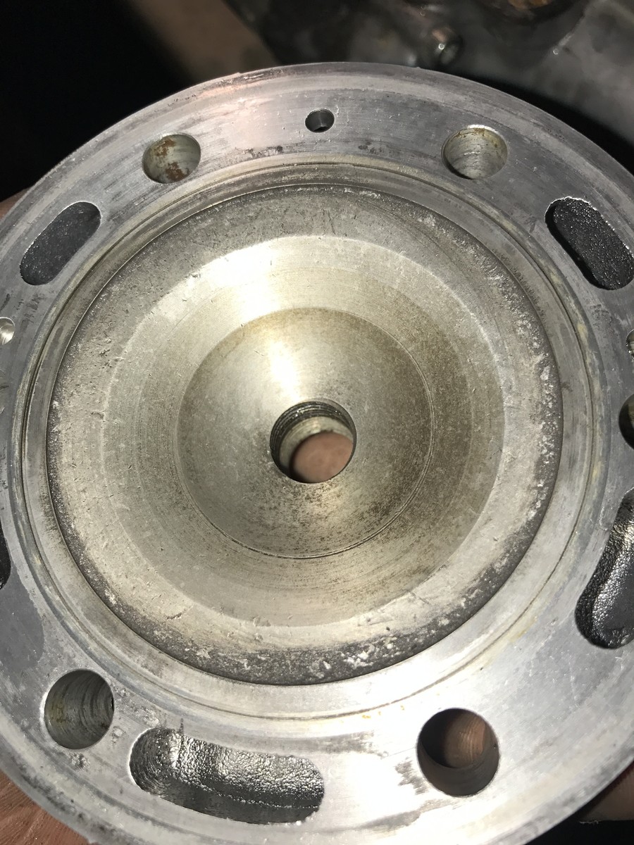

I kind of thought that too. In June I sent the head to Eric Gorr (the more I've read the more I've heard that was a mistake) to have the squish tightened up for a blend of pump/race gas 50/50. I got the head back with zero info on it. I figured he would have at least said what he did and explained things. I've been running pump93 & VP C12 mixed at 32:1 with Klotz. Don't see how it would be detonation.

FYI: Most Yamaha 250cc two strokes come with a squish setup that is right on the ragged edge of self distruction right from the factory. That is why you see a lost of the owners going to a higher octane fuel to help with slowing down or stopping this. The problem is the squish set up.
If the squish is set too tight you will be reducing the fuel mix from the edge of the piston where it is needed for cooling. The result is that the piston top and the head start to erode and pit which then makes the problem get worst and finally the piston either fails or get so hot that it deforms and caused the ring to get stuck in the piston causing a loss of compression.
If the squish is set too loose than you get an incomplete fuel burn and a loss of power.
So be sure to have it checked and rest after the cylinder is reworked as some cylinder reworking involves the cutting of the top of the cylinder to make sure it is true. The result can cause the squish to be reduced.

Eric's head design is crap and doesn't work any better than stock. He doesn't touch the factory squish band. He just cuts the head surface to tighten up the squish then cuts the bowl out to get the compression back to around stock.
I would just replate it. Only costs around $200 from millennium...
Have you checked the timing?

Yeah the head didn't honestly look much different from stock when I got it back from him. I'll have to send it to Millenium and let them work there magic. Can they fix the head also?
Here's how it looked when I got it back

Yes they can fix it as well when they have the cylinder.
The reason the piston broke is because it was ran to long and the cast stock pistons always bust the skirt off them when ran to many hours. Put a wiseco back in it and have piece of mind that wont happen again unless something catastrophic happens.
When you get it all back together you need to check the ignition timing.

Be sure to recheck the squish which ever way you go, OEM or aftermarket piston and or cylinder.

I would send the cylinder to Millennium or Power Seal USA and have it replated.
Here is a head I did for a customer and I do this as a hobby, not my full time job. I would have at least polished the combustion chamber as this has shown on my flow bench to be an improvement in gas flow.
I tried some different velocity flow on this head during my machining, this is on a KX112 and showed some improvement on the dyno, but the rider likes it better on the track and shows better burn pattern.

Very nice. I'll compare prices from the two and go from there. That head looks great by the way!

I normally use Millenium for re-plating but decided I would give PowerSeal a try this last time. I used them to plate a KX112 cylinder and they did a great job.
Like you said I don't think you will go wrong with either, the re-plating by both companies is far superior of the OEM plating.

Good deal. I'll be having them fix the head, replate the cylinder & set me up with a racers choice wiseco. Once I'm home from work I'll have to post a picture of my reeds. I think there ok to use. Just the tip of the block has a bit of a rough edge on it
